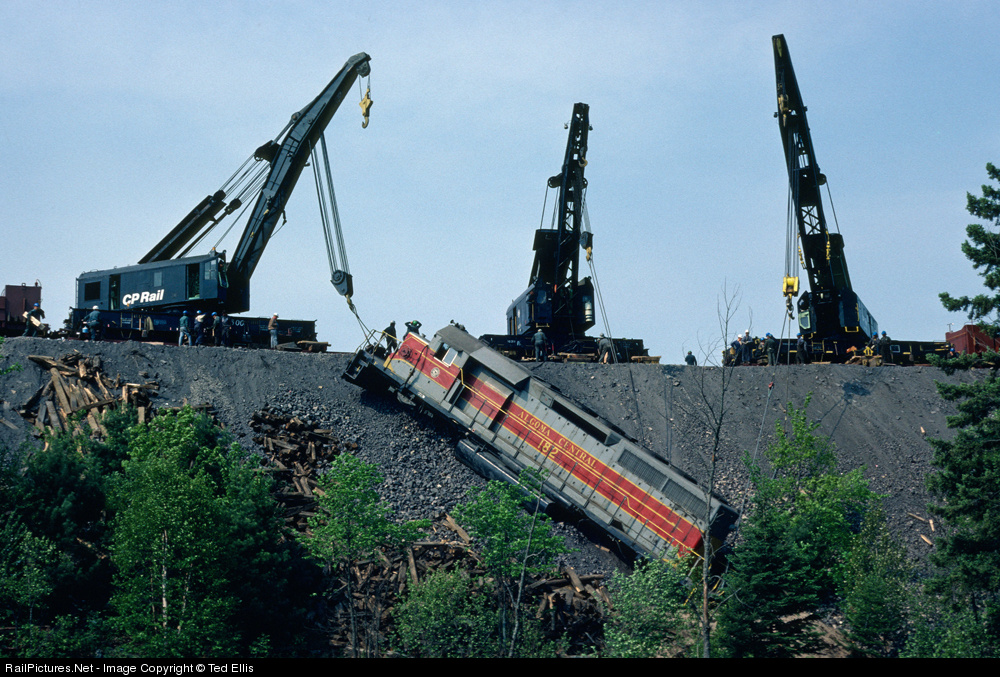

Yeah, there are a few still in operation. NS still uses them in coal country of West Virginia where roads don't go where the tracks are. Contractors can't access many of those places and derricks are still used there.
This from November of last year in Roanoke VA.
Here are THREE at work on a difficult recovery of a locomotive down an embankment.

very impressive! are those in the pictures steam too? or converted to diesel?

There are a few "Big Hooks" still in use...However none are steam powered outside of maybe..a showgrounds for a steam association or a railroad museum like Steamtown in Scranton PA, even then I doudt that they would have an operating 250 ton steam wrecker. In 1949 when that one was built diesel powered units were being built and lots more were converted from steam to diesels. All the diesels used twin Cummins HB series six cylinder or Cat engines. I worked along side a few diesel wreckers when I was going to train wrecks. They sure had the power in those old beasts. Here is one of the few realy good photos I have found of a steam powered "Big Hook" in use......
