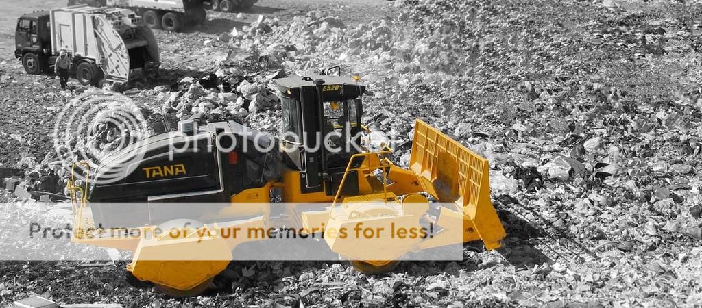

Tana E-520 Solid Waste Compactor. Options · View
FiatAllisHD41
Posted: Monday, November 23, 2015 8:17:24 PM
Joined: 5/27/2010
Posts: 1,905
A little more info here. http://www.tana-na.com/Tana%20Landfill%20Compactors.asp
Tana photos via Flickr . https://www.flickr.com/photos/8388768@N04/sets/72157629495631254/ {Edit} Would someone please fix this link ?
Tana video. https://www.youtube.com/playlist?list=PLD6F4EED3AB451ADE&feature=edit_ok

It's not a terrible design but has issues. The full width drum is nice, but our mechanics took one look at it and said no way. The other issue is that with a drum that wide you're essentially running an LGP machine. The tines may penetrate, but you're potentially not getting the deepest compaction of the machines raw weight in some situations. We run the Bomag 1172's with GPS tracking. (One with the Deutz and one has the Mercedes. It's the only one in North America with the new Mercedes. Not cool when it comes to parts, and Bomag is sourcing a new motor again soon. We'll have a lemon with poor parts availability) The operators have to turn an area red on the display to move past it. The GPS tracks how many passes are done over an area, and it won't reach red till you've reached the minimum. You could argue about time vs. cost with the Tana, but my guess is that you'd have to spend an equal amount of time, or greater, to reach the same compaction density.
My overvalued 2 cents.
Have nothing but good things to say about Deutz engines. My old 2005 Freightliner grapple truck had a Mercedes engine. Had no problems with anything on the truck or parts in America. Some of these Tana compactors are equipped with Caterpillar engines. Also I didn't think the Tana vs Bomag video was very fair. Sounded like Tana was the best one could get,but 15% more compaction isn't that much.
